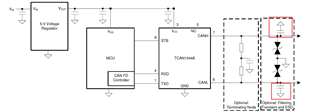

  • By the way, Does this 20pF refer to the output filter capacitor capacitance? Can 100pF be used? Because the previous customer used NXP to use 20pF, which caused the ESD to fail.
  • Alan,
    No, the ICANH and ICANL are only that high (-150mA to 150mA) in the case of a short to battery occurring on the CAN bus and a dominant state being driven. Danny was just saying that this is the designed absolute limit in the event of a fault case. The dominant and recessive state currents are listed in the datasheet under ICC in the electrical characteristics.
    The input capacitance to GND parameter that you've highlighted is the capacitance at the input of the CANH and CANL pins, and does not have to do with any externally added capacitance. 100pF can be used as filter capacitance on both CANH and CANL where you shown in red boxes on your screenshot.
