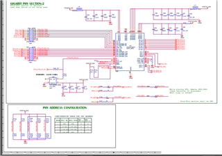

When I read the PHY ID through the mdio interface, one of my PHY devices did not return a valid ID. Clock input is 25MHz. Clock out is also 25MHz. All the voltages are properly fed to the IC.
Strap values are correct. There is no resposne from IC on MDIO lines. Please help
SCH

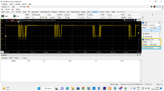

    I tried reading from below registers.
    1. PHY Identifier Register #1 (PHYIDR1) with Address 0x0002 and
    2. . Auto-Negotiation Advertisement Register (ANAR), Address 0x0004
    Even these registers read 0XFFFF like register 0x3.
    Below is the image of the MDIO data lines.
    As per the protocol, in the above waveform,
    2 bits start bit,
    2 bits read,
    5 bits PHY address,
    5 bit reg address
    are there.
    But after that i was suppose to get 16 bit data which is not there in the waveform.
    SCH
  • Hi Shradha,
    You mentioned "one of my PHY devices". How many PHYs are functioning correctly? Are they all on the same MDIO bus? What is different between a functioning and non-functioning PHY?
    Please share the schematic if you can.
    David
    Yes. I have 7 boards in which this communication is perfectly fine in 3 boards. In other boards i am facing issue. All the boards are same in all aspects.(SCH, FAB and BOM.)
    Schematic:
    SCH

  • Hi David,
    As I mentioned, all the boards are same and I am getting CLKOUT properly. One thing I missed to tell you is that I have option for 3 DP83867 on my board. My board has 3 ethernet ports. But only one IC is powered on and among other 2 PHY ic s, one is placed (Lets consider it as PHY-2) but is NOT powered on.
    The MDIO lines were shared between PHY-1 and PHY-2. I separated the MDIO connections between PHY 1 and  PHY2 because of which PHY-1 IC responded with expected 0xA231. PHY-1 IC is working.
    I powered PHY-2 on, but it is not responding . Schematic wise, both sections are same. I have connected separate MDIO lines from Processor to PHY-2 (MDIO lines are different for PHY-1 and PHY-2 ). Also I am getting CLKOUT on this IC. There is data from processor to PHY-2 on MDIO lines like it was happening in PHY-1.  I have compared the signals from working and non working PHY. PHY-2 response is not there in the waveform. I tried to read 0XA231 from the register. (Trying with same code as in PHY-1).
    I have also tried with same and different PHY addresses ( tried by making strapping pins same as PHY-1).
    Is there any special requirement to be taken care of, while using 2 PHY ics?
    Also, why PHY-1 was not responding on MDIO lines, when same MDIO lines were connected to another PHY which was turned OFF (No power was given).? ( I think Multiple slaves could be connected to MDIO lines)
    Thank you in advance
    Shradha
