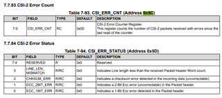

    1. Can you please read register 0x4E on each port? Want to see what errors the 954 is detecting.
      1.  A full register dump will also be appreciated including both ports.

    • Can you please read register 0x4E on each port? Want to see what errors the 954 is detecting.
    • You setup 953 in continuous but does your ISP need continuous or non-continuous?
    • Can you complete the following information? This might be a bandwidth limitation.
    1,I changed the register to non continuous clock (0x02=0x33) on 953., so 953, 954 and ISP all are non continuous clock.
    2,   I read register status for both ports.  rx0: 0x4e = c5, rx1: 0x4e = c5,and I add info.xslx  as following attachment, pls review.

    the 0x4e = 0xc5 on each port, which means the line length and line count unstable ?  how do I troubleshoot it ?

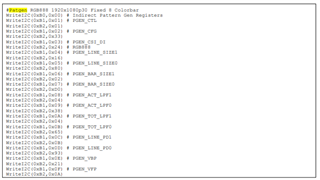

    If there is a mismatch, then we can try to enable the internal patgen on each 953 to 954 to test the data path.  Please see section 7.6 Pattern Generation for configuration. When using the patgen you will not turn on the sensors.

    You will need to look at your 953 and read the registers below. This will tell us if there is any issues on the incoming data.
    I dump the following registers value on 953, the 0x64=0x05.
    sensor's effective size:1945 (H) × 1097 (V) ,active pixels:1937 (H) × 1097 (V) ,Total number of pixels:1945 (H) × 1109 (V),recording pixels:1920 (H) × 1080 (V),But why did 954 receive the line length x line count = 0xb40 x 0x444,  the line count = 1092(0x444) from port0 & port1, why is the line count received 1092, not 1080? Because, I configure the sensor output size: 1920 x 1080.
    // 954
    {0x73, 0x4}
    {0x74, 0x44}
    {0x75, 0xb}
    {0x76, 0x40}
    // 953
    {0x51, 0xc0}
    {0x52, 0x77}
    {0x5c, 0x00}
    {0x5d, 0x00}
    {0x64, 0x05}

    lation, unbounded frame and so on. when I enabled both camera, what's more, the csi will also report errors during long time previews, then, camera stop works.
    During the long period testing do you ger small amount of errors or does it get a large number all at once?
    Have you also tried the long period testing with just one sensor?
    Can you help to run the map tool in each port? Want to determine the margin on these ports.
    ub954_margin_analysis_script.zip
    Glenn
