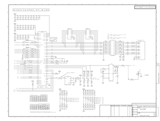

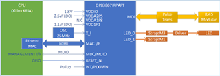

The block diagram and circuit are listed as below
Could you please advise on what could have caused this issue and the solution to it?

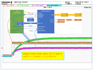

    Below is the waveform acquired by the customer,
     according to the waveform, when VDD1P1 was around 500mV when RESET_N was internally pulled up.
    Is it possible that for this reason the reset was removed before VDD1P1 reached 1.045V?
    According to the DS, the device has POR and don't require reset after power on. Also since the customer was using 2 supplies mode therefore it should have no requirement on the power sequence.
    Is there's anything you can think of that might have cause this issue?

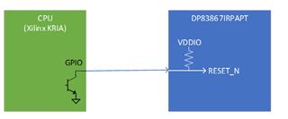

  • Hi David,
    Below is the customer's application, the input of the RESET pin is controlled by FPGA GPIO which cannot pull low until the power is on.
    For this reason they think it's highly unlikely that reset signal was pulled down before the power ramped up.
    Is there any other reasons that might have caused this?

  • Hi David,
    The scope shot you shared shows reset pin being pulled low before power ramp to the PHY, and then going high midway during the power ramp. Is there something I am missing?
    Please delay this signal by 1 second and let me know the results.

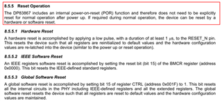

    Internal reset is marked in datasheet as below as POR(power-on-reset) function.
    I checked the datasheet again and found that the reset pin is latch-in for 200ms after the power ramp-up, this means that the de-assertion of the reset pin during the power ramp up shouldn't cause the issue as the device only gets internally reset upon power on, correct?
