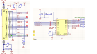

TMUXHS4212: Review of schematic with swapped p n
Part Number: TMUXHS4212
Hi, please review following schematic and advice if it might be a problem.
1) In J8 type connector Type C, pin A2 connected to C0n. (according to connector datasheet A2 is p)
2) same with B10 (is n) connected to C1p
3) in our design pins 1 10 are not connected. is it problem?
