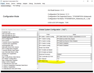

First of all, in order to use Flash commands, in the technical manual written that you have to unlock first. SLVAE21A  never referred to this requirement. When I try to unlock with the task LOCK and UnlockCode=0, the command is also rejected. I'm stuck here.
I created the full flash hex content in C using Application Customization Tool, but I don't know how to burn this configuration to the flash over the PD? Your helps are highly appreciated.
    I think the TRM is referring to this bit.
    You can change this in the APP Config GUI. It looks like it defaults to off.
