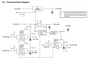

Hi team,
Could you team me how to connect 5V_SYS, 5V_CON if I don't use the load SW_? Can I leave it open or connect to GND?
Also, could you let me know the max. and min. values of pullup voltage of SCL_SYS, SDA_SYS?

Hi Kuno,
Thanks for your answer!
Sorry, I wanted to confirm the pullup resistance of SCL_SYS, SDA_SYS, not voltage.
Typ. value is 5kohm, but no min and max values. If you cannot give an exact value, approx. range is okay.
Zeming
Hi Zeming,
Sorry, I can not provide the min&max value, I check the Starfish website, but this device is too old, so I can not find anything in the Starfish, and the designer also leave TI, so I can not ask someone for help, sorry.
