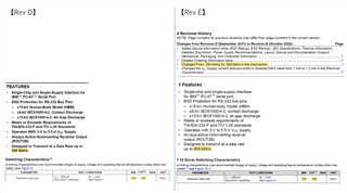

Hi Team,

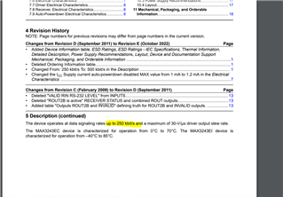

I found the following comment in the 4 Revision History of datasheet Rev E.
> Changed From: 250 kbit/s To: 500 kbit/s in the Description
However, there is no difference between Rev D and Rev E in the datasheet.
Is this comment a typo?
If no, please let me know what changes.

    So in REV D - in the description section it states "up to 250 kbits/s" not the feature section - this was supposed to be updated in the Rev E version - but it wasn't as it still says 250Kbits/s.
    Thanks for bringing this to our attention as it seems the change wasn't made.

  • Hi Parker-san,
    Thank you for your prompt reply.
    I have two questions.
    [Q1]
    I understand that “Changed From: 250 kbit/s To: 500 kbit/s in the Description” is correct information but "250 kbit/s in Description" was not fixed yet.
    Is my understanding correct?
    If yes, would you correct the datasheet?
    [Q2]
    I understand that Rev D and Rev E data specs have not changed.
    (So, you just want to change the description in the datasheet.)

    1. Yes your understanding is correct - and it is noted in our datasheet change to do list; it may be slightly lower priority as there are a lot in the list currently and the specification table is correct - the revision wasn't made and its a description which is more marketing than performance guarantee.
    2. Yes - the specification for data rate did not change between devices - only that the description is referring to min. guaranteed data rate not typical as was the intention.
