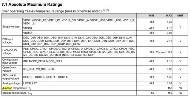

hi,
customer need the recommended operating conditions for Junction temp since we only have absolute spec, they need that to do thermal simulation:
thank you

Hi Yuan,
We do not have data for typ junction temperature. So we only have the max rating. However, this can be calculated by using the values in the TermalInformation table. Specifically the Junction-to-ambient thermal resistance value.
