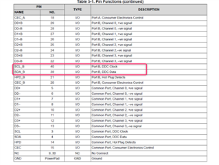

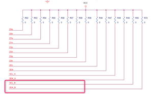

Above is TS3DV642-Q1 demo design.For part A, why does HDMI and I2C connect to VCC with 0Ω resistor? Is it for sink termination ? and there is no mention the level of VCC .
Below  is our use case,  Whether  partA is required or the value of resistor should be changed up to test result?
For part B, from my experience, it’s uncommon to add a coupling capacitor for HDMI bus ,and whether 0.22uF is accurate?
