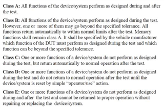

Customer used TCAN1042 and test FMA for CHAH&CANL short to VCC. Requirement shall be minimum class C according to the ISO16750.
From the spec showing below, Class C should be able to return automatically to normal operation after the test.
However, in customer's test, the CAN communication can't turn back to normal after the short test unless POR.
Do you have any ideas what might be wrong during the test or advise any way can reset the part but not POR?
