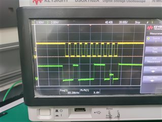

But from the scope capture, only single I2C send command seems to be working not multiple.
I checked the status register, I2C0MCS in debug mode of CCS. The DATACK and ERROR bits are set to LOW.
The pull-up resistors being used are 2K each. There's no scope captur showing ACK as LOW.
So,I used just one I2C write to the slave this time as suggested by you,i.e. I2CSend(DI_SLAVEADDRESS, 0, 0, 0, 0x01) but the scope capture remains the same.
Additionally I tried the function I2CSend(DI_SLAVEADDRESS, 1, 0, 0, 0x01) for transmitting one bit and the scope capture was as below
Also, I'm testing using Launchpad and EV-Boards of ADUM3151 isolator and IO-Expander EVM (setup shown below). I'm giving I2C SCL, SDA signals from Launchpad to IO Expander EVM via isolator.
For the IO-Expander I'm using slave address as 0x27(screenshot of schematic given below), since all three address lines (Pins 2,3,21) in the EV-Board are pulled up (we've replaced the IC TCA6416 and soldered TCA9555PWR in the evaluation board).
Please guide for the same.

Kiranjit,
It seems that your system does not have any I2C command working, not even a single one since it NACKs and stops further communication.
Can you help me understand how the clock is being generated?
It seems that the clock is not consistent in its bit period.
Also, the bit marked here:
Are we confident that on this rising edge of the clock that a "1" is being clocked? It seems very close to the edge of the SDA transition and is hard to tell if a "0" or "1" is being read. I2C requires a minimum data set-up time of 250ns for standard mode speeds (<100kHz). Setup time is the minimum time required for data to be stable on the SDA line after transitioning before it is sampled.
If this bit is being read as a "0" then you will end up with the wrong I2C address of course. Maybe try re-running the tests, but set A2 to "0" and see if the device ACK's.
Tyler

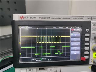

You have shown three captures.
In the first one, the SDA line changes at the same time as the rising edge on SCL. This is wrong, and might be interpreted as a STOP condition.
In the second and third ones, the SDA line shows overshoots at the rising edges. This indicates that the pin is configured as a push/pull output, and not as a bidirectional open-drain pin as required for I²C. This has the effect that the slave is not able to send the ACK bit.
All this implies that the I²C module and pins are not configured correctly. (I do not know anything about the TM4C.)
Hi Tyler and Clemens,
I tried setting A2 as '0' and so, given 0x23 as address (see scope capture).
My code is already attached in the previous post. Please suggest how do I provide proper setup time through this code?
Also, I'm using I2C0 (PB2, PB3) for SCL and SDA in cde and those are the 2 lines I'm giving to my IO expander after pulling up with 2k.
Please give feedback on how and where I need to make the changes.
Kiranjit
This waveform again has a rising edge on SCL and SDA at the same time, which is not allowed. And the SDA pin does not appear to be configured as an open-drain pin (which implies that the GPIOPinTypeI2C(GPIO_PORTB_BASE, GPIO_PIN_3) call did not work).
I do not know about the TM4C. This should be moved to the microcontrollers forum.
Kiranjit,
I second Clemens answer on the rising edge on SCL.
If you look at the red lines, the SCL is sampling SDA on the edge transition rather than 50% into the data bit. Something is wrong with the timing here, which is probably an error in the setup of the I2C signaling.

Hi Kiran,
Here is my best guess to what is happening right now. Based on the scope capture, it is looking like the rising edge of the clock is sampling on the rising edge of the data line (SDA). This is not how I2C works. The clock signal should be sampling about 50% into the data bit, not right at the edge. Because the clock signal is sampling on the edge of the bit, it may clock in data of "1" or "0" data is uncertain.
Your scope capture shows 7-bit address followed by a write bit followed by a NACK, since SDA is HIGH on the 9th clock edge.
This is telling me that the target/slave device did not recognize the I2C address, and this might possibly be due to a bad timing.
I am trying to follow page 8-9 of this application report here and comparing it with your code.
You define a slave address above:
#define DI_SLAVEADDRESS 0x27
but your scope capture shows:
0x27 is the address you are attempting to send: 0100111
We are seeing in the scope 0?00011
which is wrong regardless of whether the "?" is a "1" or "0". We are sending an address that the device does not recognize, and I think this is a timing issue. I don't think the error lies in the I2Csend or I2Creceive commands. I would think this error would occur in the INIT function.

Scope capture:
I2C bus is still sending wrong address.
0x27 = 0100111
scope = 0100011
I also don't understand why the bus is half-way in between a NACK and ACK. The scope should show a complete NACK since the device is receiving a wrong I2C address.
0x27 = 0100111
scope = 0100011
>>> The address being sent is 0x23 only and not 0x27.

Please see the scope capture for 100kHz frequency

Hi Tyler,
Yes, you're right/ It looks like you're right about the isolator.
I checked without the isolator and following was the result.
Also, I changed the code to directly use the functions for sending the data in the main itself after initialization as below and didn't use the function I2CSend() this time.

>>> Yes, we received the new isolator ADUM1250 EV-Board and checked the output. Following are the scope captures using this isolator for 400kHz.
Kiranjit
Kiranjit,
It looks like the waveforms are okay except for a couple artifacts occuring on the SDA line. Are those voltage spikes expected based on the data you are trying to send? I don't think these are proper I2C signals.
