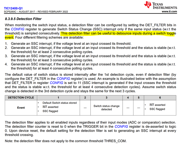

    Whether switch debouncing is taken care by the TIC12400 device?
  • Hi Hemanth,
    Yes, the device has a software debounce approach that allows you to configure up to 4 consecutive polling cycles of a stable reading that was different than the previous state before it will generate an interrupt to indicate a switch's state change.  If the switch is bouncing during the polling cycle, the successive polling cycles may sample different values while it is stabilizing.  Requiring multiple consecutive polling cycles to be of the same value is equivalent to a hardware debounce filter.
    The device calls this a Detection filter and is described in section 8.3.9.5 of the datasheet.
