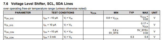

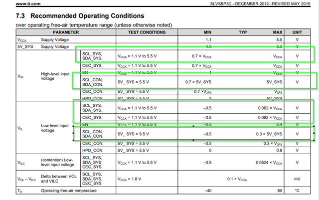

Hi team,
My customer is checking this device, and he found VOL and VIL do not meet the I2C spec.
VOL max=0.17×VccA (0.4V officially)
VIL max=0.082×VccA (0.3xVdd officailly)
Do we need to follow the datasheet or official specs? And why there are differences?
