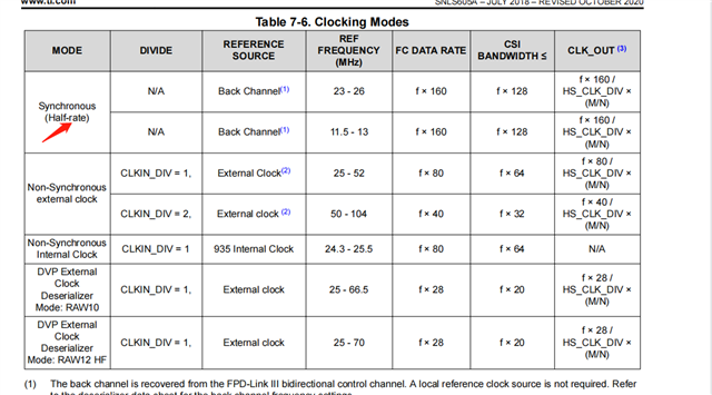

Part Number: DS90UB935-Q1
Can you tell me what the reference clock on the 954 side is 24.576M FPD LINK in the synchronous mode of 935 is 24.576 * 160? What does the red arrow mean by a half speed?
Hello Tony,
Half rate is a Typo there. The FC data rate is 24.576 * 160
