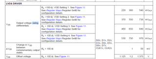

For 948 VOD swing, test is over 1200mVpp, in below with no LVDS load; if connect LVDS to LCD, add LVDS load, the swing become to 400mVpp.
so i want to know the swing over 1200mVpp is right? But the datasheet setting max only 970mVpp.

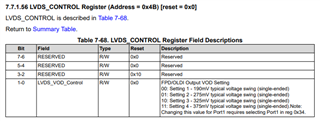

Hi Songlin,
What is the value of register 0x4B? This setting has an effect on the swing of the LVDS Output.
Ryan
Hi Songlin,
The spec in the datasheet specifies the typical swing while there is a load applied to the output (RL = 100 Ohms). As such, the 400mVpp should fit within the spec defined for setting 1.
Seeing as it does, I see no issue with this.
