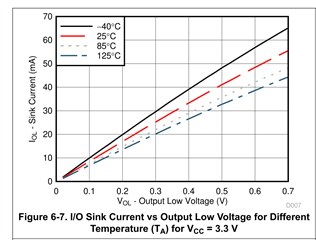

May I know the VOL value of TCA9539-Q1?
Since it is a push-pull structure I assume that the VOL of Px port should be 0V, am I right?
I notice below figure shows the VOL variation based on sink current, I believe it assume that there is another source on the line and sink into the Px port then cause the VOL.
Is my understanding correct?
