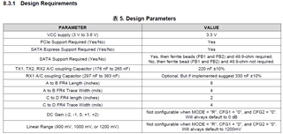

Part Number: TUSB1002A
We adopt TUSB1002A for a SATA Gen3 design.
Which MODE pin must be select?
0=Basic Redriver Mode or R=PCIe/Test MODE.
AAMOF we select R for table5 but not work at all.
And then select MODE 0 work well.

mode is R will work with power state.
mode is 0 is just normal redriver mode
Brian
Is that mean still MODE"R" can't communicate device and host controller each other?
no, Mode R support U0/U1 which supports host and device communication each other.
Brian
