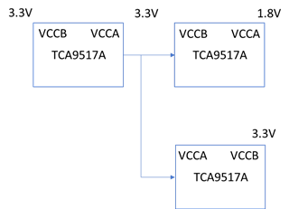

Hi TI teams,
Refer the datasheet: B-side ports must not be connected together.
We have concern if we A-side is cascaded A side. Is it fine for design?
Please refer our design diagram as below. Thanks.
