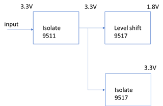

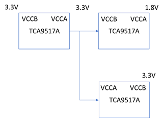

Hi TI teams,
We are searching for the solution about component for isolate and level shift.
In this diagram as below, we use TCA9511A in this application. However, we found that the VOL(MAX) will be around 0.4V.
In the input side we need to keep under 0.4V. But it seems that will around 0.6V+0.1V (off set).
Please help us to find the solution for this. Thanks.
