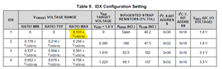

    I reviewed the DS90UB935-Q1 schematic that you provided. Here is my feedback:
    -The resistor connected to the IDX pin does not match any of the recommend resistor configurations provided by the DS90UB935-Q1 datasheet. If you are trying to configure the I2C 8-bit address of this pin as 0x30 (1.8 V I/O Voltage), I recommend that you switch the 39 kΩ resistor with a 40.2 kΩ resistor, so that the configuration of this pin matches the recommendations on the datasheet.
    -The resistor connected to the MODE pin does not match any of the recommend resistor configurations provided by the DS90UB935-Q1 datasheet. If you are trying to configure the device for CSI-2 synchronous mode, I recommend that you switch the 4.7 kΩ pull down resistor with a 10 kΩ pull down resistor, so that the configuration of this pin matches the recommendations on the datasheet.
    -The voltage rating of the DOUT- AC coupling capacitor is lower than what is recommend. For this component, I recommend that you use a capacitor with a 50 V rating instead of a capacitor with a 25 V rating.
    -The power supply ferrite beads being used in the design (L11, L3, and L10) do not meet the recommended specifications given by the DS90UB935-Q1 datasheet. As stated by the datasheet, these ferrite beads should have an impedance of 1 kΩ at 100 MHz, and a DC resistance less than 25 mΩ. For the power supply connections of this device, I recommend that you use ferrite beads that meet these specifications.

    Here are my comments:
    --> The value of the resistor is not important, the voltage at the pin is. According to the datasheet as long as the voltage at the IDX pin is lower than 0.131*VDD18 then correct address will be set. 39K or 40.2k will not make any difference.
    --> The value of the resistor is not important, the voltage at the pin is. According to the datasheet as long as the voltage at the Mode pin is lower than 0.131*VDD18 then correct address will be set. 10K or 4.7k will not make any difference.
    --> DOUT- is not connected to the outside world so it won't be exposed to high voltages. Can you explain to me how the voltage rating causes this weird behaviour?
    --> PoC filter is perfectly fine for this application. It has been used in multiple projects and millions of cameras are produced with no issues.

  • Hi Houssem,
    I do not expect the voltage rating of the capacitor to be causing the behavior that you have observed with this device. I mentioned this is my initial review because the voltage rating of this capacitor did not match our datasheet recommendation.
    In my initial feedback, I was referring to the ferrite beads connected to the VDDD, VDDDRV, and VDDPLL pins of the device. In the DS90UB935-Q1 datasheet, we recommend for the ferrite beads connected to these pins to have an impedance of 1 kΩ at 100 MHz, and a DC resistance less than 25 mΩ. I mentioned the ferrite beads connected to these pins (L11, L3, and L10) in my initial review of the schematic because they do not meet our recommended specifications. Similar to the voltage rating of the capacitor, I do not expect these ferrite beads to be the cause of the behavior that you have observed with this device.
