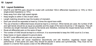

Hi Team,
We planned to use MIPI CPHY CSI interface.
With respect to Layout routing of the CPHY CSI signals, Is that all trios can be routed as single ended or differentiality to be maintained like DPHY routing.
Kindly clarify b providing some references.
