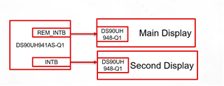

    Attached is the schematic diagram of 948 and test points and VS and HS test waveforms under single and dual outputs respectively.
    https://e2e.ti.com/cfs-file/__key/communityserver-discussions-components-files/138/1.7z
  • Hi Alan,
    Thanks, I appreciate it. The schematic seems fine, so I would say just make sure no settings on the scope are incorrectly set, as you should not be seeing any negative voltages.

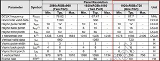

    But the customer reported that there is still a problem in this project: when 941 is configured as Splitter Mode, Tianma’s screen cannot be lit, but LG’s screen can be lit; when configured as Single FPD-Link III Transmitter mode (Port 1 disabled) Tianma ‘s screen can be turned on steadily. Can BU give some troubleshooting methods?
    Do different modes have different configuration requirements for the screen? Or are there other checkpoints?
  • Hi Alan,
    When using different modes, such as splitter mode, there are certain requirements that have to be met for successful operation.
    Section 8.4.4, section 8.4.5, and section 8.4.6.4 of the DS90UH941 datasheet detail some of the requirements needed for splitter mode.
    What are the properties of the screens? Are they the same dimensions and PCLK?
    Ryan
  • Hi Ryan,
    Both screens are 12.3 inches, with a resolution of 1920x720. The following figure is the specification description of the LG and Tianma screens. The CLK is somewhat different. The LG is 89.6MHZ, and the Tianma is 87.7MHZ. The code configuration is set according to the typical value. ,see attached.
    In addition, during the test, the customer directly lowered the PDB of 941 to use the default register configuration (the screen parameters have normal configuration), the LG screen can be lit but the image is abnormal, and the Tianma screen cannot be lit. Does it mean that the problem is not with TI941?
  • Hi Alan,
    Could you possible illustrate how the video is being input into the 941AS?
    It is recommended that both screens have the same resolution and properties, so having differing PCLKs could cause an issue.
    When you say the customer directly lowered the PDB of the 941, do you mean they just used PDB to reset the device to its initial configuration? I imagine the would revert it to initial configuration set by MODE_SEL pins, so unless you are making config changes after the device starts, it should be the same.
