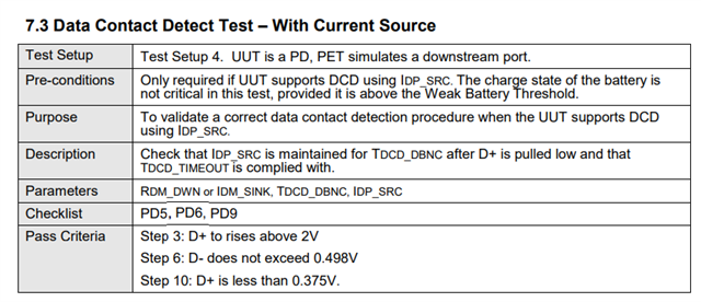

Hi Team,
My customer tested the BC 1.2 and found the test item failed at "Data Contact Detect Test – With Current Source".
Can you please help provide related support?  The following is the relevant information provided, thanks.
1. The test method and inspection standard of this test

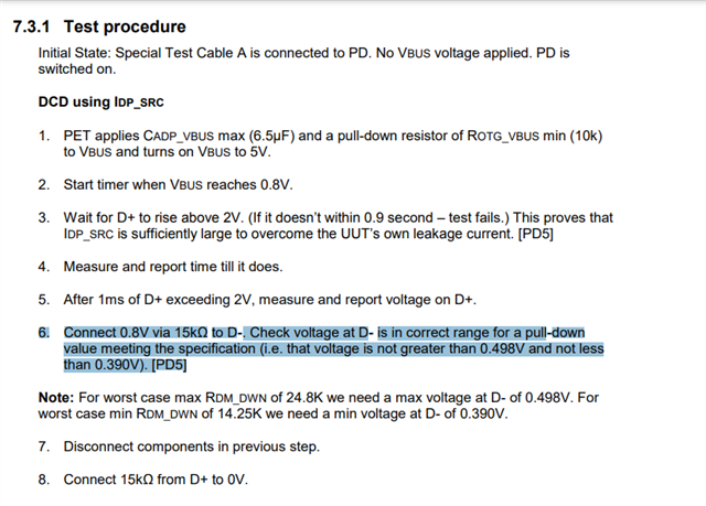

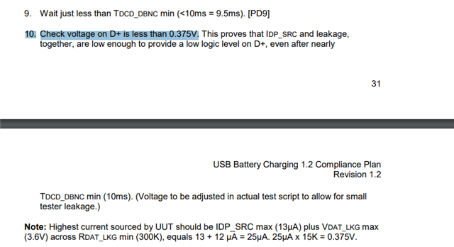

2. Fail at item 6 and 10
(6): D- measured at 0.076V, far below the minimum standard of 0.390V
(10): D+ measurement is 0.596V, which is higher than the standard 0.375V.

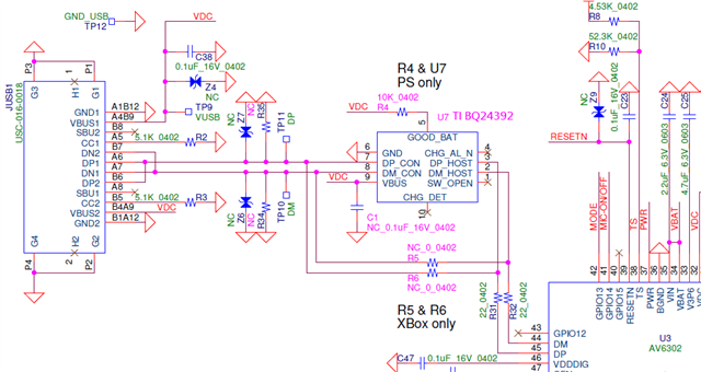

3. Schematic
