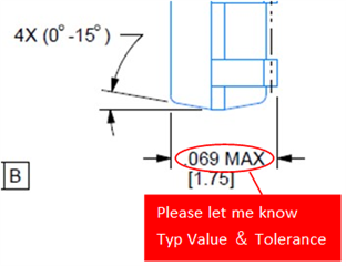

Part Number: TCAN1057AEV-Q1
Dear Expert,
Could you please let me know the typ value and tolerance for package height of TCAN1057AEV-Q1 ?
Data Sheet discribes only Max value.

Ted,
The typical overall height is 1.65 mm and the minimum is 1.55 mm.
Danny
