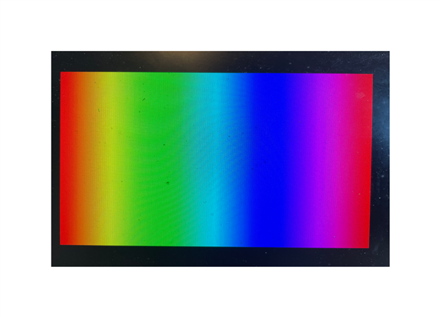

We have just designed a board using a TFP401A to decode an HDMI signal into a 24 bit parellel RGB signal that is then sent to a standard 50-pin TFT display module which uses a 24-bit parallel RGB bus. After configuring an EDID with the correct resolution, the image shows up with the correct resolution but the completely wrong colors. We've tried a couple of different things and have double checked the pin-out but have been unable to root cause the issue so far.
Link to to images and schematic
Here's a summary of what we've done:
TFP401 Configuration:
See attached schematic page for more info.
DFO: set to TFT (low)
ST: set to high (33 ohm external resistor in series with each RGB line)
PIXS: set to 1px/clk mode (low)
STAG: set to high (unstaggered)
OCK_INV: set to falling edge (low)
Images:
Image 1: Correct colors:
Image 2: Colors shown on display

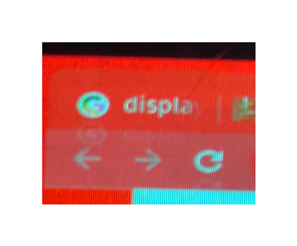

Image 3: "Ghosting" issue. Note that the ghost image is not actually burned in and moves with the window on the display.

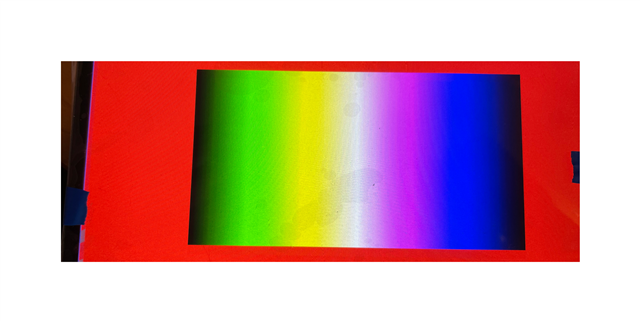

Observations/Issue Description:
1. Red and Black appear inverted. This is odd as it does not seem like a simple R/B or R/G swap.
2. Image shows some "ghosting" that tracks the image on the display. It looks like two frames are overlapping each other with one frame being vertically offset from the other.

UPDATE
Turns out the color issue was caused by the red channel being inverted. This was caused by a swapped D2 pair coming from the HDMI line. After swapping this pair the color issue went away but I am still seeing the second "Ghosting". Any clue on what could be causing this issue? I will post more pictures later.
If anyone has any ideas on what could be wrong help would be greatly appreciated!

    Can you measure the ODCK, DE, HSYNC, and VSNYC with a scope? Do they match the input video timing?
