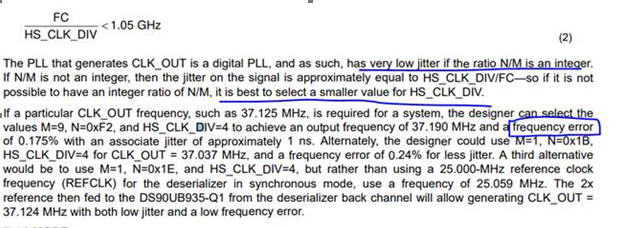

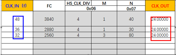

my customer use Non-Sync-external clock mode.
they want CLK_OUT=24MHz, and CLKIN is integer.  you can see the following can meet this:
according to our DS, it seems the Frequency error is 0. so i want to check if there are any differences among CLK_IN=32Mhz,36Mhz,48Mhz, which one do you prefer? thanks

    You are correct in that each of the solutions chosen by the customer will result in a frequency error of zero. Since this is the case, the preferred solution should be the one that results in the least amount of expected jitter. For each of the chosen CLK_IN frequencies, here is an estimation of the expected jitter:
    CLK_IN = 48 MHz, Expected Jitter = 1.041666667 ns
    CLK_IN = 36 MHz, Expected Jitter = 1.388888889 ns
    CLK_IN = 32 MHz, Expected Jitter = 1.5625 ns
    As shown by the calculations above, a CLK_IN value of 48 MHz will result in the least amount of expected jitter. Therefore, the customer should prefer this solution.
