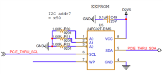

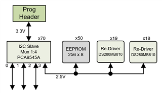

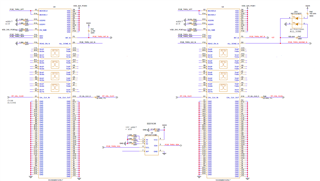

Hello TI technical folks,

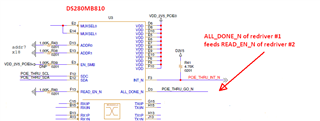

I'm using the DS280MB810 in the following I2C bus architecture:
with the following schematics:

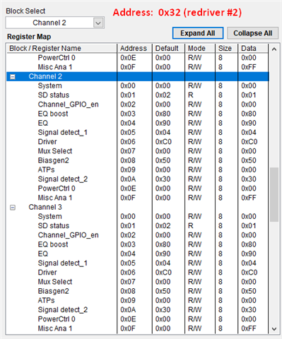

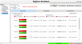

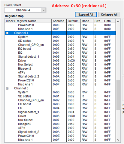

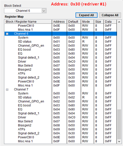

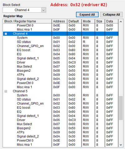

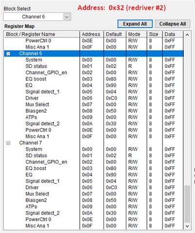

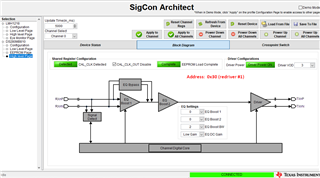

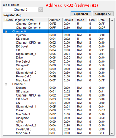

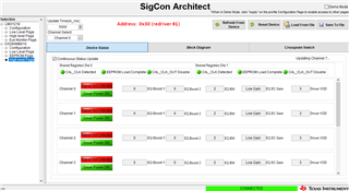

I've programmed the EEPROM with the .hex file appended beow and read back it's contents to verify that it was correctly programmed. Upon applying the D2V5 power, I am able to communicate with the redriver over I2C, but it doesn't appear that the redriver configured itself from EEPROM correctly (or even at all). Specifically, when I probe the ALL_DONE_N pin on redriver #2 it measures 2.5V, meaning that it hasn't finished configuring from EEPROM. Moreover, when I read the contents of the redriver registers over I2C from SigCon Architect, the desired EEPROM values are not present.
I replaced resistor R40 with a zero-ohm resistor, thinking that perhaps a hard-ground was needed at the READ_EN_N of redriver #1, rather than a 1K PD. But, that did not change the behavior and ALL_DONE_N still measures 2.5V at redriver #2. I've also scoured the .hex file contents against what application report SNLA244 says it should contain, and it looks correct. Basically, I set up all channels with these parameter values: VOD=2, EQ1=5, EQ2=0, Boost=3. And the .hex file seems to contain the correct data values for those parameters.
I'm stuck at the moment and looking for hints at what may be going on. Thanks.
-Mark
