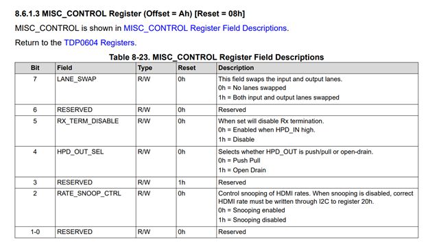

TDP0604: Question on the HPDOUT_SEL pin
Part Number: TDP0604
Hi Team,
I'm not quite clear about the description on the HPDOUT_SEL pin in the datasheet. It says open-drain is not supported in pin-strap mode so this pin should be left floating or pulled down. Does it mean that we only need to pull this pin high when we're in I2C mode and if we need this pin to be open-drain?
Thanks!
