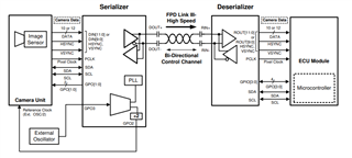

DS90UB953-Q1: Can 953 support spread spectrum under external clock mode
Part Number: DS90UB953-Q1
Hi Expert,
Can 953 support spread spectrum under external clock mode ?  And how to use the spread spectrum under external clock mode ?
David

  • Hi Cindy,
    If use a external Oscillator which can support SSC input to 953 CLKIN pin , can this work for SSC? if not ,  why?
    Looks like 933 can support this, with a external Oscillator which can support SSC.
    David
  • Hi David,
    This is not supported. The 953 can only support SSC if it is 1) connected to a partner deserializer such as the 954 and 960 with an SSC REFCLK applied to the DES and 2) is operating in synchronous mode with the DES. This is the way these devices are designed. You will still get SSC on both the forward channel and back channel doing it this way.
    I am not sure where you got this information, but the 933 cannot support an external oscillator with SSC. The 933 PLL is not designed to track an SSC clock input.

  • Hi Cindy,
    Thanks for your feedback.
    1: The 953 can only support SSC if it is 1) connected to a partner deserializer such as the 954 and 960 with an SSC REFCLK applied to the DES and 2) is operating in synchronous mode with the DES. This is the way these devices are designed. You will still get SSC on both the forward channel and back channel doing it this way.
    What is the SSC range of the 954 or 960 REFCLK input?  Can below range  be supported?
    What is the difference between SSC REFCLK  in 954/960 and SSC REFCLK  in 953? The two side PLL is different?
    2: So similar to 953, 933 can not support SSC REFCLK  in 933. How to use SSC with 933, also need to apply the SSC REFCLK in 934 or 933 can not support SSC?  You mentioned "The 933 PLL is not designed to track an SSC clock input.", what is the special requirement of PLL to  track an SSC clock input?
    David
  • Hi David,
    You can refer to Table 7-3 REFCLK Oscillator Specifications in the 954 datasheet for more information. I cannot read the picture you attached, but the SSC range depends on the type of spread spectrum you are using. If using center spread, the SSC modulation percentage can range from -0.5 to +0.5%. If using down spread, the SSC modulation percentage can range from -1 to 0%. The SSC modulation frequency has a max of 33kHz.
    Only the 954/960 PLL can support SSC applied to the REFCLK pin. In synchronous mode, the 953 uses the deserializer reference clock extracted from the backchannel, so that is how the 953 spreads the forward channel as well.
    The 933 does not support SSC. It requires an external clock since it is a DVP device, so it cannot use the deserializer REFCLK as its clocking source. I cannot discuss the detailed design of the 933 - it is just important to know that you cannot apply SSC directly to a 933 or 953.
