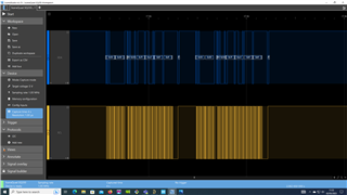

I am currently at the stage where i am storing the EDID for my TFT resoluation and frequency etc on an EEprom which is read through the I2C bus when the hdmi source is connected. The Eeprom used is CAT24C208.
After connecting the HDMI source (my PC) to my board, the exchange of EDID is successful and the 'monitor' is detected and appears on my PC as having been detected and ready for display. My issue is however that regardless of this successful exchange of EDID there is still no image data being transmitted over the HDMI differential pairs, which tells me i am still missing something.
I measured the I2C bus on a different working AD board to observe what is occuring and noticed that after the EDID is transmitted there is some additional data that is sent to address 0x3A - after doing some research have i correctly identified this as being the HDCP? If so, why is HDCP necessary for my application?
Could you please advise me on what I need to do to get my computer to transmit video data to the Chip?
I have attached my EDID raw data that causes the PC to detect it as an external display, and i have also attached a waveform screenshot and file (use ScanaStudio to open https://www.ikalogic.com/scanastudio/ ) for your reference.

Then reads device address 0x3A
and regiter address 0x40
  81,00,00,00,
Then tries to read from 0x40 but only gets NACK and stops
Then waits 333ms and reads 0x3A again
    You would need to find a source that does not support HDCP or disable HDCP in your current PC.
    David
  • Hi David,
    I disabled Intel(R) Content Protection HDCP Service for my graphics card. This stopped the request for data to I2C device 0x3A, so im pretty certain HDCP is now off. Although after 350ms there is still a request that ends in a NACK.
    After connecting the HDMI cable and my PC detecting the 'monitor' there is still no display data on the differential lines that would result in an image. Is there anything else I am missing?
    There is also a a request to read/write to address 0x40 on the I2C bus after the EDID is exchanged - this ends in a NACK, but could it stop the vidoe data from being transmitted?

  • Hi David,
    I just wanted to compare the I2C data from my board to a board that was purchased with the TFT.
    As you can see, on a working AD board (identical EDID and TFT), the data from register 0x3A is very different than my board, even when the Intel(R) Content Protection HDCP Service is turned off or disabled. Is this still the HDCP?
    Thank you,
    Kacper
  • Kacper
    The HDCP protocol is detected based on the incoming DDC read/write transaction to the HDCP DDC slave device with address 0x3A. So 0x3A is used for HDCP.
    David
