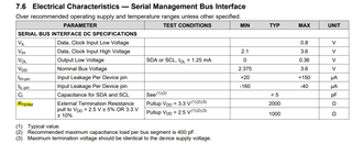

Part Number: DS125BR111
Is the 1KOhm resistor highlighted in the image above the Rterm discussed in the Table?
Trying to discern if the table is talking about the pull-ups on the I2C line or on the ENSMB pin.
Hi Jacob,
You're correct, Rterm refers to the PU resistor on the ENSMB pin.
Lucas
