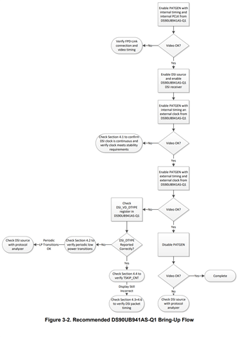

  • Hi Tonyx,
    Did you review the 941 DSI bring-up guide I previously attached? Can you clarify where in the flow diagram below you are failing?
    Please provide the following information:
    • PCLK being used
    • DSI configuration:
      • CLK mode
      • Burst mode, non-burst mode with sync events, non-burst mode with sync pulses
    • 941 Clock mode being used (DSI reference clock mode, external reference clock mode, internal reference clock mode)
      • If DSI CLK mode is being used (no external REFCLK used) then DSI CLK MUST be in continuous mode
    • Can you provide current scripts?
    • Provide oscilloscope waveform of DSI CLK and DSI data signal to observe when it is entering LP11 mode
    • Schematic of 941
    We adopt the brush mode, which can control the register of 941 to directly brush the lvds. The screen switches between green, purple, black, white and progressive colors
    What is brush mode? Are you using 941 Pattern Generation in this case? Does this use internal timing, or rely on external clock?
    Logan
