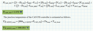

  • Hi Eric,
    The customer used the below formula for estimating the power dissipation and thereby finding the junction temperature. But the calculated Tj is greater than 150 Deg C.
    please note that the load resistance is 50 ohms.
  • Hi Marvin,
    The most significant part of the calculation listed here the Vsup_typ * Idom portion. Using the values listed here, this accounts for 1.44 Watts of the total calculated value. This portion does not account for the 50% dominant time estimation nor does it assume any of the power will be dissipated externally by termination resistors. This portion also includes all of the power that has been previously calculated as it multiplies the whole voltage drop across all previous circuits (we've already accounted for the voltage drop across the CAN driver with the Vcc calculations).
    This last variable (Vsup_typ * Idom) should be changed to the following to accurately represent the power dissipated by the 5V LDO when deriving the Vcc supply from Vsup under dynamic loading conditions:
    ... + (Dcan * (Vsup_typ - Vcc) * Idom) + ((1-Dcan) * (Vsup_typ - Vcc) * Irec)
    This calculation will yield a much lower power requirement for the LDO of around 580mW (vs the 1440mW). The total power dissipation would then come to around 700mW for a junction temperature of ~25C above ambient (using only the RthetaJA estimation).
