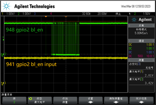

1. The gpio2 (bl_en) and lock pin of 948 are measured as shown in the figure below. When abnormal, the gpio2 (bl_en) and lock signals are abnormal. GPIO2 of 948 outputs backlight enable signal. The input signal of GPIO2 at serial terminal 941 is stable.
There is also a phenomenon: When the host plays a color bar picture or a solid color picture, the probability of a splash screen is much less. Now it looks like the splash screen is caused by the 948 lock out and is also related to the characteristics of the video picture.
According to the above phenomenon, could you please provide some troubleshooting suggestions?

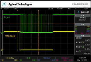

    Now we can ignore the jitter of GPIO2, because we found that the flash screen is accompanied by the unlock and relock process by observing the lock pin of 948.
    The problem now is that 948 will occasionally unlock.
    By replacing different hosts, harnesses and screens, it is found that the 948 unlock cannot be eliminated. However, when we change the video frame rate output by the host from 60Hz to 59Hz, the picture is stable and 948 unlock phenomenon is hardly observed.
    Could you lease help us analyze the possible causes.
