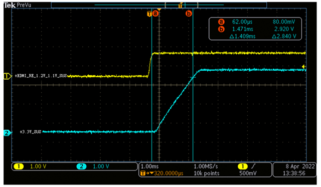

As we request VCC power on before VDD, but my customer found in their system, VCC ramping slowly, shown as below. Will it fail? Is it a POR request?

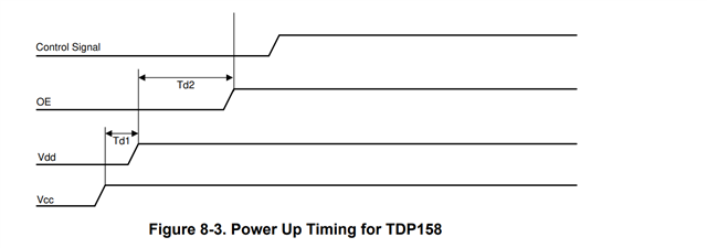

Reference to the TDP158 POR timing from the datasheet. As long as TD2 is meet, TD1 does not matter.
