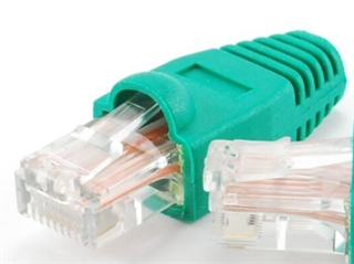

Hi Sir,
Our DP83867IR single External Loopback test at -40'C or 70'C has a problem when turned on. But this problem only occurs in the first few seconds before the machine starts the test, and the number of single External Loopback errors will not increase afterward.
Do you have any recommended settings? Can you provide a register to confirm that a single external loopback connection is established, or how long should be delayed before sending data to test?
Processors: AM6442
DP83867IR: The general state is Auto-Negotiation, and the test mode is a single External Loopback (that means need to change status)
Fail rate: 1/11 (9%)
