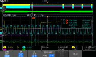

  • Background and phenomenon: During the whole machine test, log on to the interface of a web page management machine through this network port, and then restore the factory settings and the default values. After that, there will be an automatic restart process of the minimum Linux system, after the restart, the network port cannot be connected and the Ping fails.In Linux, the operation command ethtool eth1. the Link status is NO, and the actual network cable is plugged
    Depaint:The fault phenomenon can be reproduced;
    The method on Link can be used for software operation: under the condition of continuous power supply, ifconfig eth1 down on the network port, and then ifconfig eth1 up, you can run the ethtool eth1 in Linux to detect the Link status. Yes

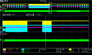

  • Supplementary Test waveform diagram: When reset occurs, the MDIO bus has the reading operation process. Channel 1 is MDIO data, Channel 2 is MDC clock, and channel 3 is reset
    I wanted to confirm this; you are saying that link light is on which is meaning there is link. However, register is saying no link? What value are you reading for the register? Have you read this multiple times over, as this bit can be latched low?
