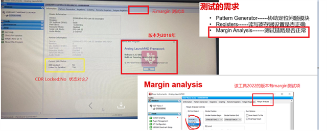

The customer plans to use ALP to test Margin Analysis, but the version downloaded from ti.com is the 2018 version.
According to the ALP guidance document, ALP software version 2019 or later is required for Margin testing.
I hope BU can provide a version download compressed package or link that can test Margin's ALP.
Customers are anxious to carry out relevant tests.

    The ALP version on the TI.com website is our latest framework. In order to update it to its latest version, you need to download the ALP-PROFILE-UPDATE file on the same page and install it to the same folder as ALP. This should give you the correct version you are looking for.
