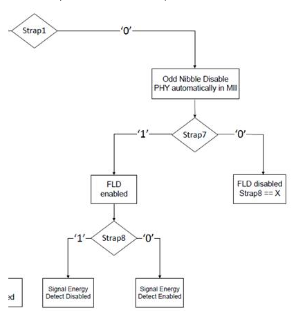

Hi

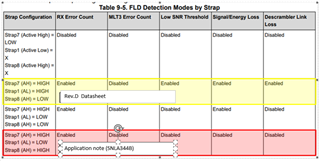

My customer is designing an enhanced mode by applying DP83826.
They were designed by referring to Rev.D Datasheet, but the guide in the application note(SNLA344B) is different.
FLD detection modes by strap are different as shown in the table below.
Can you tell me the advantages and disadvantages of changing like an application note(SNLA344B)?
    Per datasheet Rev F, "For EtherCAT applications or applications with Fast link drop enabled and expect to handle Baseline wander packets, it is recommended to disable signal energy detect, which can be done by setting Strap8"

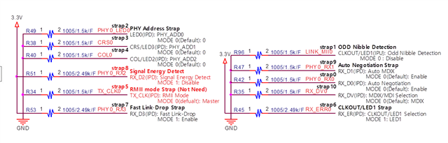

  • Hi
    My customer has additional questions.
    1. What function is Odd Nibble?
    2. What problems can you encounter when you enable the 'Low SNR Threshold', 'Signal/Energy Loss' and 'Dramble Link Loss' features in an EtherCAT application?
    3. Strap options
       : It did not work properly when set to the recommended strap, the EtherCAT application in the datasheet.
           -. Device Scan not performed on EtherCAT Parent.
           -. Device scanned normally when Strap8 setting value changed to '0'
           -.  Regardless of the mode of Strap1, Strap8 seems to operate with the MII/RMII Mode setting, so please check if there is a problem with
                the Strap Option in the circuit below.
    Per SPRACC8A:
    " Detection of transmit error in odd-nibble boundary, which extends TX_EN by one additional TX_CLK cycle and behaves as if TX_ER were asserted during that additional cycle."
    Are you referring to Figure 9-11? Can you please check 0x467, and 0x3 for the different strapping configurations to see if they took effect?

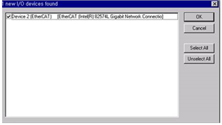

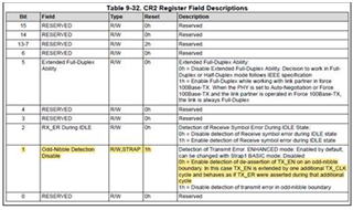

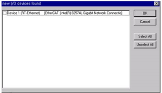

  • Hi Gerome
    1. Contact Strap Option
      When I set it up with the recommended strap, the EtherCAT application on the datasheet, it didn't work properly, so please check again if there is a problem     with the strap options.
       - Do not scan devices performed on the EtherCAT parent (TwinCAT3)
      - Device scanned normally when Strap8 setting value changed to '0'
    2. Inquiries regarding PHY Register setting status according to H/W Strapping status
        - Strap1 is currently in a disabled state with PDR connected, but it is in the Enable state when checking the register.
          Please check if there are any problems.
          ODD Nibble Detection Bootstrap Status: H/W configuration to current "0"
        PHY Register on datasheet (P.66 / CR2 Register)
       information of PHY register read : 0x100(Enable)
    I cannot interpret this register data information. This last figure is the readout for Reg 0xA?

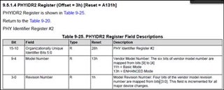

  • Hello, I am YOO.
    It is difficult to check data in the current TwinCAT program with the requested Register address.
    Only registers from 0X00 to 0X0F addresses can be checked, and subsequent data are difficult to check.
    During the PHY register confirmation process, 0xA register data was confirmed.
    Different from the Odd Nibble Detection (Strap1) H/W configuration, Reigster recognition status was confirmed as shown in the figure above.
    In addition, when checking the register address 0x3, the Device Revision information is different from the Default value, so please check if there is a difference in phy function depending on the h/w Revision. Please refer to the picture below for details.
    - PHY 0X3 Register ADDR.
    - PHY 0X3 Register Data (TwinCAT3 Readed Data)
    This is an older revision of DP83826, as denoted by 0x3[0] = '0' instead of '1'. We would recommend switching over to the newest revision of this device and see if this issue is still observed.
