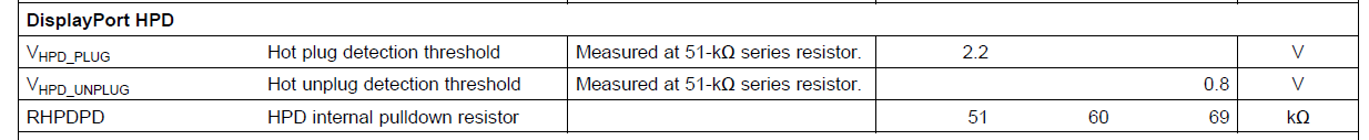

The DisplayPort HPD from the data sheet is:
On my current design I have a 51.1k resistor tied to the HPD pin. The other side of the resistor is tied to pin18 of a DPort connector and is sitting at 3.26V. I measure 1.68V at the HPD pin of the IC.
This is consistent with a value of about 50k for the internal resistor. This seems to be working with my system, but it doesn't pass the threshold requirement of 2.2V for Vhpd_plug.
Using the suggested 51k nternal resistor and external 3.3V with a minimum value of 51k internal you would have only 1.65V at this input. The Vhpd_plug says 2.2V is the threshold.
Going the other way, with 69k internal you would still only have 1.9V at the input.
If the 3.3V was increased to 3.6V, the value with internal 51k would be 1.8V and with 69k would be 2.07V.
I must be missing something here. I'm assuming the maximum for this input is 3.6V, so it seems like a smaller series R should be used to meet the 2.2V spec.

  • Hmmmm.... in looking at this more, there is a note for the pin that says 'Measured at 51k series resistor'. Maybe this is the same as the voltage at pin 18, the input side of the resistor. [I wish the spec sheet was clearer].  If that is the case, then I am fine with a 3.3V HPD at pin 18, and this matches more closely the 2.0V min detection spec I saw for this pin (see below).
    This would be then @2.2V with 51 internal and 51 external 0.9V at the SN65DSI86 pin, and with 69 internal and 51 external 1.26V at the SN65DSI86 pin.
    If the spec is really referring to the other side (the connector side) of the 51k external resistor, then 0.9V must be enough at the input pin to say HPD is high.
    Connected to a 5.3V pin with the 69k internal resistor the voltage at the SN65's pin would be 3.0V, so still below a 3.6V limit.
    I'm guessing I was reading the spec sheet wrong and if I connect to a 3.3V HPD level at the pin I should be fine.

  • Hello, WST,
    The HPD input requires a 51-kΩ 1% series resistor.
    Zach
  • I have that, 51.1k, but I was just confused about the specification. Is the 2.2V spec'ed at the 'input' side of the resistor (the one connected to the display port interface) or the SN65DSI86 pin? I'm assuming because of previous discussions that it is at the connector side.
  • WST
    The VHPD_PLUG spec is at the DSI86 pin.
    HPD has a minimum of 60-kΩ ±15% internal pulldown resistor, so you can use a series resistor to meet the VHDP_PLUG requirement. The 51kOhm is only an example that actually has been implemented and worked, however, you can use another resistor value with the voltage divider network.
    David
  • Can you read through me original question. Your answer doesn't make sense. The VHDP_PLUG value is NOT met with a 51k resistor if the 2.2V needs to be at the pin and the HPD pin on the connector is at 3.3V. I suspect the VHPD_PLUG spec is at the other side of the 51k resistor; that is the only way it works.
  • WST
    My point is that you don't have to use 51k. You can use another resistor value to meet the 2.2V requirement.
    So 3.3V x 60 /(R + 60) = 2.2, with R then being 30k.
    David

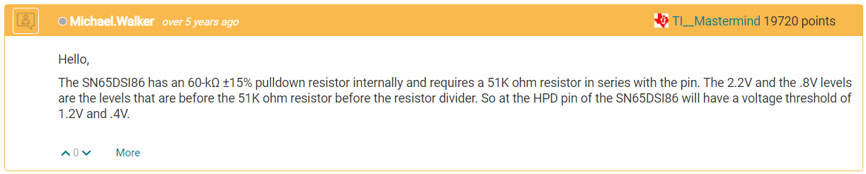

  • And I was saying above, that if I did that, with say a 21.5k so that I could meet the spec with a 3.3V HPD at the connector, then if there was 5V at the connector from an old monitor (I think 5V is allowed), then the voltage at the IC pin would be worst case (with the 69k +15% value) of 4.2V, too high for the IC. There is no value of resistor between 21.5k and 51k that works for both 3.3V HPD at the connector and 5V HPD at the connector. 51k doesn't even work with 3.3V at the connector, you only get 1.65V at the pin.
    Also, I found this earlier comment by another TI support person that disagrees with your VHDP_PLUG location:
    (1) SN65DSI86: the HPD pin voltage confuse - Interface forum - Interface - TI E2E support forums
    I'm thinking they are correct because of the "Measured at 51k series resistor" in the datasheet.
    I'm just wondering who is correct. If need be, I'll have to add a buffer from the connector and then divide the output, or just let the maximum be 3.3V at the pin [Is that OK? - the datasheet doesn't say]. Again, the 2.2V makes more sense to be related to the connector, since this matches the HPD voltage spec of HDMI/DPort of 2.2-5.3V.
    If that is incorrect and the maximum voltage on the HPD pin can only be 3.6V or less, then the 21.5k would be ok. But I still don't see how a 51k works or why the datasheet would suggest that.
  • WST
    I double checked on the HPD implementation and you are correct. the 2.2V spec'ed in the DSI86 datasheet is on the connector side, not at the DSI86 pin side.
    David

    8) The earlier answer from the link above (copied below) seems to be correct, the 2.2V and 0.8V levels are before the 51.1k ohm resistor, at the DPort HPD pin 18 of the connector.
    Using the 51K resistor with a 3.3V HPD level gives 1.65V (at the lowest level of 51K internal) and that is > 1.2V actual pin threshold. It also protects the pin from high voltage if connected to a 5V HPD level (which may not exist) since the highest voltage would be around 2.9V.
    I think the datasheet should be clearer as to the Vhpd_plug location, say "Measured at the connector side of the 51-kOhm series resistor" or something like that.
