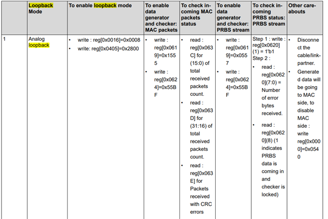

Hello
The phy chip model we use is DP83TG720S-Q1. Currently, the phy chip is already working properly. However, due to testing needs, we need to configure loopback for testing. The mode of loopback is Analog Loopback With Inbuilt Data-Gen. I configured according to the Table 7-2. Datapath BIST Programming of the datasheet. However, the registers corresponding to the Data Generator and Data Checker do not have any values. How should I configure registers to enable Analog Loopback With Inbuilt Data-Gen ? Can I configure a list of registers?
