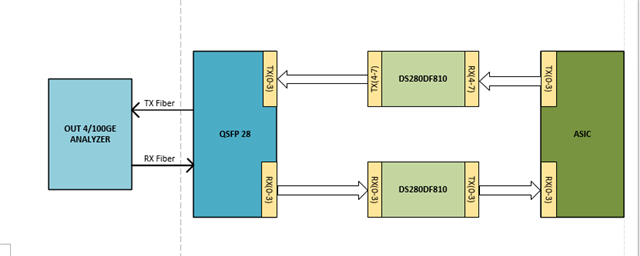

I am using DS280DF810 with the above setup with 100GE Ethernet and OTU4 data rates. In which 100GE data rate is working fine but getting FAS error in analyzer with OTU4 datarate,
I am using the following settings for DS280DF810 retimer. Please suggest in which direction should I change the pre-cursor and post-cursor value to solve the FAS error.

  • Hi Miller,
    Currently, we are not able to measure the eye diagram in ASIC so we changed the test setup to physical loopback as shown in the figure with Insertion Loss of 13dB. In this setup
    In this setup as well we are getting the FAS and Inv. Marker error with FEC enabled.

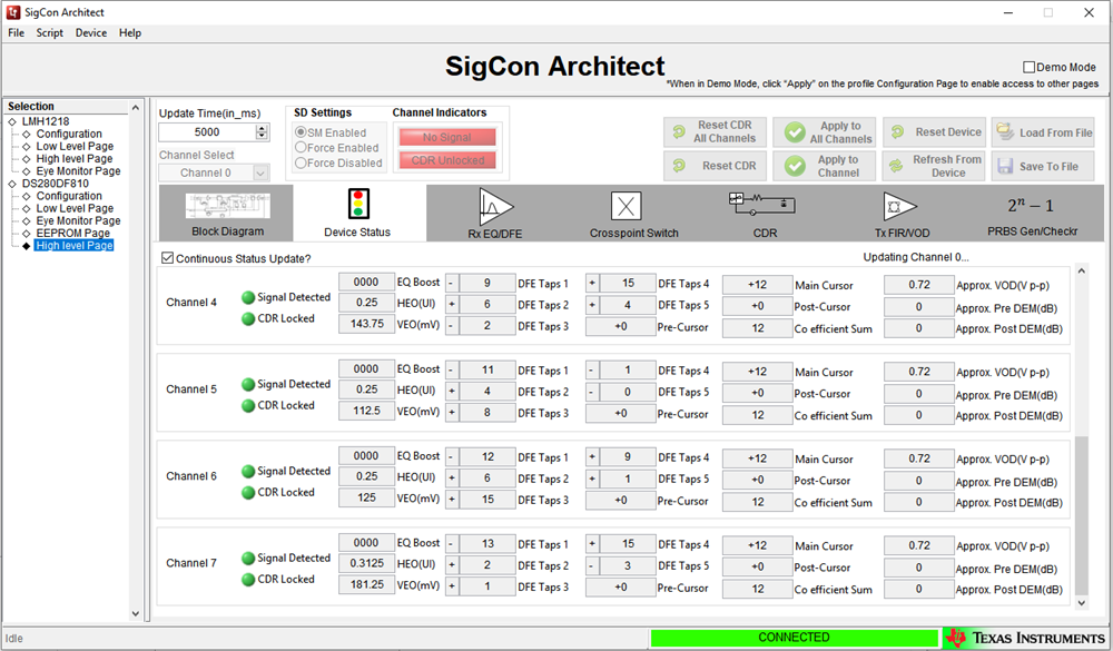

    Please check the device status of Retimer 1
    Device status of Retimer 2
    Also attached the register dumps of both the retimers.

  • Hi Aman,
    Are you able to enable the PRBS generator on retimer 2 and check for PRBS errors on retimer 1?  In general, the HEO/VEO you are observing is smaller than what we would typically target.  Typically, it is recommended to have at least 0.4UI, 200mV for HEO/VEO.  You could try adjusting TX settings to see if this can be improved.
    In general, the HEO/VEO you are observing is surprising.  If you transmit Ethernet data instead of OTU4, does this change the observed HEO/VEO?
