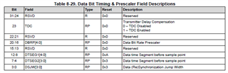

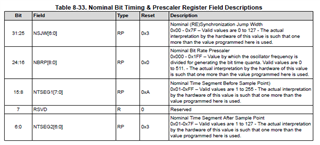

Hi All,
I understand everything in the related thread, just one thing bothers me. Why does the datahseet not reflect the fact that values programmed in register 0x100C are interpreted as + 1. For register 0x101C it's mentioned explicitly. I know it has to be correct, the driver software shows it. Also DBRP=0 wouldn't make sense or at least it should be marked as an invalid value if register 0x100C would behave differently compared to register 0x101C.
Best Regards
Juergen
