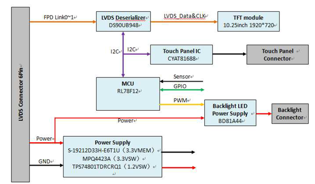

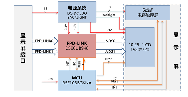

         In the following block diagram, I am not clear whether i2c can communicate directly when ds90ub948 is directly connected with mcu, and whether ds90ub948 needs special Settings. The write address of mcu is 0x78.
         Thank you very much for your reply !

  • Hi Chaoyi,
    If the MCU is connected to the DS90UB948, yes, you should be able to communicate with it by send commands using the address of the 948. For communicating with the MCU, the 948 should not need any special settings, no.
    Please let me know if you have any other questions.
    Ryan
  • Hi Ryan,
         The I2C address of DS90UB948 is 0x2c, the write address of MCU is 0x78, and the read address is 0x79. If I write the value to 948 now, shall I use 0x2c or 0x78.
         In addition, I also want to know whether the link is automatically completed when 947 and 948 are connected, and whether I need to make special Settings.
    Chaoyi
  • Hi Chaoyi,
    If you are writing to the DS90UB948 from the MCU, the address you should be using to write/read should be 0x2C. Same goes with any device connected to the DS90UB948.
    For special settings, make sure the MODE_SEL pins on both devices are correctly set. If those are setup correctly, yes, the devices should automatically connect.
    Ryan
