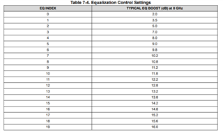

Why are the corresponding results of the following two pictures different at 8GB? Where am I going wrong? Thanks.

Hi Nasser,
Thanks for your support. I still don't understand...
Taking EQ=7 as an example, Gain=8 is shown in Figure 1. But Gain=10.2 is shown in Figure 2.
Charlie
Hi Charlie,
I got your point. Please use figure 1 - this data was taken from a device. Best option if to use IBIS-AMI or s-parameter model of the device.
