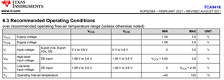

Please see below for customer feedback and additional concern:
"Thanks for the information ,
Similarly, I couldn’t find VIH and VIL [logic inputs for SCL and SDA]
As mentioned logic inputs only for OE pin."
Gerald
The I/O pins of the TCA9416 are not digital. For voltages below the lower supply, it acts as an analog switch (i.e., the output voltage is almost the same as the input voltage). For higher voltages, the switch is open, and the output voltage is determined only by the pull-up resistors.
