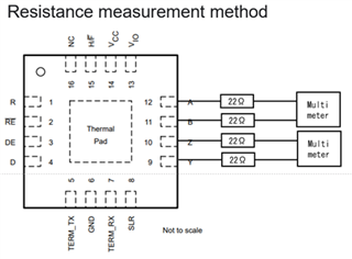

Under the following conditions, only the highlighted area has a high resistance value, is this a problem? Communication is working even if the resistance is high.
Half / Full duplex Termination resistance configuration TX(pair) RX(pair)
Full TX: ON, RX: ON 10.18M ohm 160.9 ohm
Full TX: OFF, RX: OFF 16.67M ohm 124.3k ohm
Half TX: ON, RX: OFF 160.7 ohm 298.6k ohm
Half TX: OFF, RX: OFF 109.5k ohm 298.5k ohm
Masa
  • Does "pair" mean that you are measuring between the two bus pins? A differential transmitter drives the bus by connecting one output pin to VCC and the other one to GND. So there is no connection between these pins inside the transmitter.
    If there are any termination resistors (inside the transceiver, or external), you should be able to measure them. So it appears that the configuration is not what you think it is.

    What pins are you measuring the resistance from on the TX and RX pairs?
    The customer has measured pins 11 and 12 for RX and pins 9 and 10 for TX.

  • Hi Masa,
    1. Is there anything else connected to the pins when measuring the resistance?
    And a few questions from my last post that would be helpful in identifying an issue.
    2.. What VCC and VIO levels are being used in the system.
    3. What voltage level is applied to the TERM logic pins?
    4. Is the customer changing the termination while the device is operational - i.e. do they turn on the device and then apply a logic signal to the TERM pins?

  • Hi Parker,
    Thank you for your investigation.
    Sorry for the late reply.
    A. Two of 22Ω resistances are connected in series.
    A.3.3V is applied to Vcc and Vio pins.
    A. 3.3V or 0V is applied to the TERM pins according to the command.
    A. Yes, Voltage is applied to the TERM pins after both Vcc and Vio are powered on.

  • Hi Nao,
    Thanks for the detailed reply I appreciate it!
    So if possible - I would like you to run the test again - but set it up slightly different.
    Can you attach a pull-up resistor - like 4.7k to 10k from VIO to the TERM pins or if that test is hard in the current system - can you direct connect VIO to the TERM pins, then power up the device, then measure the impedance in full duplex mode to see if the resistance value is more in line to what you expected. The device isn't designed to have the TERM pins changed on the fly - and I think that could be part of the issue why the resistance measurements you are getting are higher than expected.
    Please let me know what the results are after this test so I can verify if this is the actual issue.
