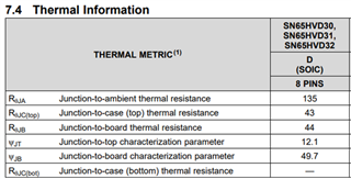

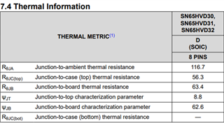

Hi Team,
We received PCN letter.
Then, Thermal Information of SN65HVD32DR is changed.
Could you please let us know why Thermal Information was changed?
<Rev L(Old)>
<Rev M(New)>

Sometimes, thermal information changes because TI did better measurements or improved the computations.
But this is not the case here. The PCN tells you that there is a new fab that also uses a new die. So the device itself has changed. Old chips are described by the old thermal information, new chips are described by the new thermal information.
