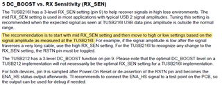

We are using TI USB2 Redriver in our design. We have placed USB2 Redriver next to USB port controller(PI5USB2546HZHEX) in our main board.
When we check SI results in actual boards, we observed that , we did not see much improvement with Redriver . We are passing Eye margin with & without redriver in our design.
- We would like to understand Why we did not observer much improvement with Redriver?
- Is our redriver placement length from SOC is optimum? or need to place in some other location based on the length given?
- Attached our current design Redriver snippet, is there any EQ setting needs to be fine tuned with current placement location to get any improvement?
